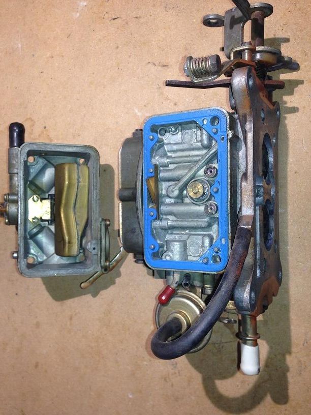

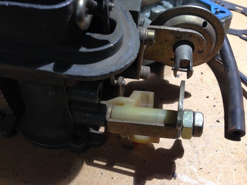

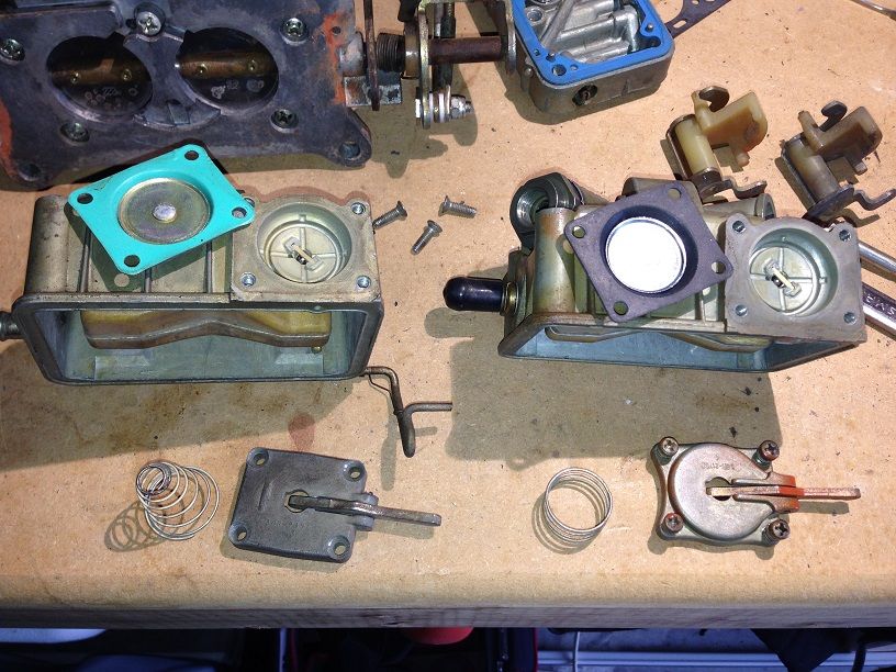

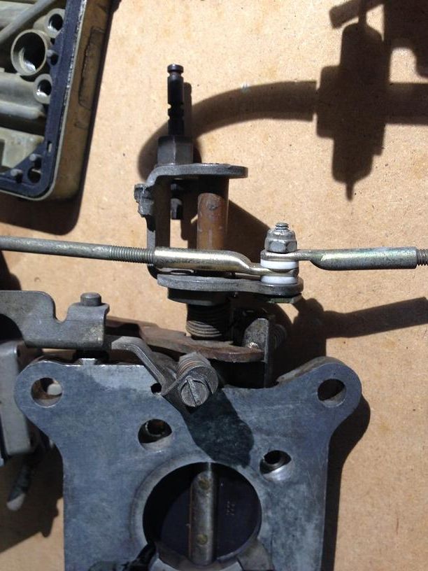

Here are a few questions and pictures.
First, were the clutch head type screws used in 71?
See them on some accelerator pump covers and a few other places.
1st picture shows the accelerator pump covers. My old one on the left and I am sure it had the wrong spring. Probably a float spring. I am going with the one on the right.
2nd picture shows a bent choke cam stud. Actually, the stud was replaced by a bolt, and I have just straightened it out. I am keeping my choke disconnected anyway, locking the flap in wide open position.
3rd picture is my "new" inboard, showing the vent baffle which I didnt have before.
4th picture shows my old accelerator arm (broken off) and I didnt even know. I am transferring over the linkage and connector only to the new inboard. Was does the accelerator arm even do?
Hopefully I can make one good, well performing set when I am done, and will probably put all the remaining parts on ebay. I am sure many of the parts can still be used.
And David, I can send you back your float bowl if you like.
It just got to the point I didnt feel safe with the old set.
« Last Edit: April 08, 2014 - 10:24:09 pm by tommyg29 »
Picture 71a shows the accelerator pump covers. My old one on the left and I am sure it had the wrong spring. Probably a float spring. I am going with the one on the right.
That spring (on the left) is for a vacuum secondary pot. Wrong spring

Where to start
 The arm that is broken off is for the idle solinoid , it hold up the idle speed until the key is shut off to allow the throttle to drop full closed so it will not run on .
 The Vent on the bowl is 71
 the Clutch screws I am not sure about but there is a special driver to turn them .
 Brad is right on the spring , it is a vacuum spring , the one on the right is correct .
 The pump cam does 2 things [try this on an Eddy carb] , it controls how much fuel is pumped both / degree of movement & total volume , so all cams have 2 holes to position the cam differently , as the throttle is opened it may move a lot or very little instantly some engines need more immediate shot , some less depending on vacuum to draw in fuel from the venturi , position 1& 2 are different in immediate movement on every cam , also when you floor it you get a total volume of fuel so each cam will have a different total amount also . & cams , 2 positions each , 1 has 3 so 15 total possible cam choices ! The shooter is the second part of the equation , small adds fuel slower over a longer time , the larger ones are opposite , basically you want to go as close to the minimum  fuel delivery without a bog or losing response .
