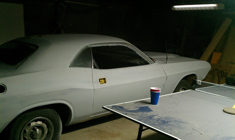

Hello All,
I want to first say that this site has already been awesome in helping me decide what I want to do to my new challenger and its amazing how much effort people put into making such a good community. Thank you in advance for reading and/or answering my questions!
Some background: I'm a 20 year old college student currently working full time and going to school full time, it's been tough but worth it, but that means that I don't have as much time as I'd like to work on the car.  I bought it primarily because I love/grew up around muscle cars (never thought I could own a dream car so soon!) and secondly to have something positive to put my money towards instead of the usual partying and whatnot that goes on. I'm hoping for it to become my DD though maybe by this summer or sooner :woohoo: but I know how that goes...
I bought the challenger a few days ago for 4k. Very little rust, has a good body for the most part, but she needs an engine, exhaust, driveshaft, probably brake work, and the interior is pretty rough.  The car has a rebuilt, what I'm assuming is 904 or SB 727 (those exist right?), and I'm also going to be getting a 440 and BB 727 (both need a rebuild) and other parts like bumpers that are included in the purchase price in a couple days.
I'll post the VIN up or search it myself and post the results when I get home :naughty:
I plan on selling/trading the BB stuff for a rebuilt 360 (or most likely just the bottom end of one). Couple questions:
1. A 360 long block will fit fine with 318 motor mounts and all of that right?
2. I found a 97-01 360, that should be ok as far as not needing a computer and stuff if I carb it?
3. Would you guys recommend just getting a painless wiring harness?
4. There's a switch on the outside of my trunk that I can tell was for a battery, I think it's for racing regulations but what is it exactly? Should I also mount my battery back there?
5. There's another foot switch under the E brake, is that just to realease it or is it something else for racing?
6. Any recommendations for a good replacement radiator?
7. I'll be doing the exhaust myself, probably side exit true dual off the headers (no muffler for a while, maybe glasspacks), pros/cons of that idea?
8. Would like to add power steering and power brakes, is this difficult?
My first car was an 87 Iroc, I replaced the 305 with a 350 in that among many other things so I have some decent mechanical ability, but I'm definitley still a newbie and even more so with Dodges. Driving a lifted navajo turqoise (blue/green) 94 Cherokee around Salt Lake City right now in case you see me! Not that they're rare or anything haha. I'm also far away from home so my tool selection is pretty limited, but I'll be slowly gathering tools from pawnshops/classifieds.
The vision: Primer gray and blacked out grille will be the theme for a while, paint is my last concern. Some sweet polished or black C6-like rims (definitely not final decision though). A reliable well handling daily driver, but as cheap as possible (reliable > cheap > fast). Paying for eveything on the car myself, I'm lucky enough to have school/rent partially covered.
All opinions/comments are welcome! Thanks for reading  :2thumbs:
Mods, let me know if this is an appropriate way to post pictures.
« Last Edit: September 30, 2012 - 03:41:39 AM by Prime72 »

Hey Youngster  :wave:   The head light dimmer switch is on the floor pan
You will have issues with installing the newer model small block
Auto zone sells a radiator
Battery disconnect switch in the trunk for track rules maybe.
Wonder how your wiring is up under the dash   (race car)
Car has power steering on it in the picture
If funds are slow for school and work, find an old running car from the 70's that's all rusted and beat up and consider the drive train out of it.
You can get a 318 drive train almost given to you to get all the bugs worked out for under 5 or 600. Then as you get things dialed in, you can be the master mechanic and start building up your combo.
No RT in 72   JS or jh vin code will show on the dash  does it have a fender tag or a build sheet under the back seat?

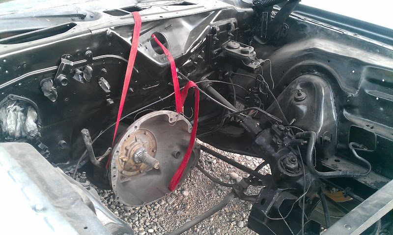

I'm sorry it has been so long since I've last posted. Work and school have been keeping me quite busy. I have been making progress on the chally though. I hoping to drop the engine in next weekend, I just have a few questions.
The motor mounts I bought seem cheaply made but it was all that they had, the nuts are barely welded on there, is that ok? Besides that, the bolt that threads into the mount is not nearly wide enough so there is quite a bit of play on the K member bracket. I have the old mounts and they are a different style with just a nut from the bottom to hold them although it does seem hard, but not impossible to get a nut on the underside of the bracket. Which is best?
The trans is hanging by a strap and one support near the back side of it.  Is this the only support for the trans or is there a forward one too that I'm missing? Also, is it recommended to install the trans and motor as one piece?
Thank you, your help is greatly appreciated. I can't wait to hear this thing run!  :burnout:

The rear of the trans is a trans crossmemmber with a transmission mount installed on the tranny.  This is the only mount, the bellhousing hooked to the engine is your front support. The hole in the K member is bigger, you will be glad it is to. The nuts on your mount itself looks to be poorly welded, but are known to be that way, usually 2 weld spots. The passenger mount on your engine, on the stand, looks like a truck mount.

Thank you for the reply, I don't know what I'd do without your guys' help. I'm glad I'm not missing a crossmember and that the play in the engine mount will be ok. But wow great catch, the engine did come from a 72 truck. Will those brackets not line up properly with the k member?
Also, I picked up my flexplate today but I haven't been able to figure out exactly how it all goes together between the block and the trans. Do I bolt the plate to the crank, then line up the TC in the trans, then push them together and bolt the plate to the TC, then the trans to the block?
Thank you

Those brackets will not work in an e body. you need the correct engine mounts. 67-72 b body or 70-74 e body also a few others, but truck,...no   The flex plate bolts are tq'd to the crankshaft at 90 ft lbs. It will seem you are putting it on backwards, but the buldge will be out and the outer bolt holes will be close to the block. If you put it on backwards, you will break something . once the trans is bolted to the block, the tq converter will pull up to the 4 bolt holes. It only bolts on 1 way and 1 way only. Or all 4 bolts will not install. you may want to test fit it first, then paint a mark on 1 bolt hole and vert to know where it,s at.  Also, since it is your first time, you should consider a manual. When parts break or installed wrong, it can get costly.  You need to know and understand what internal and external balancing is. The tq verter and balancer has to be right, or you will be posting about a vibration next. The little issues you don't  know, will kick your butt.
Ok thanks, that just saved me a lot of trouble. I'll get to looking for some different mount brackets. And good explanation of the plate and TC, makes sense to me. I thought that the 4 bolt holes all looked square with each other but you're right, I even thought for a second that it wasn't gonna line up at all, but it did end up lining up perfectly.
Now that you've mentioned balancing, does the harmonic balancer need to be in any particular position when I put the trans and motor together? And the truck that the engine came from was a manual, are the balancers different for an auto?
Any particular book manual especially recommended?
