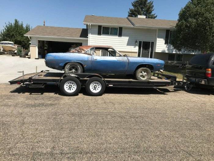

I picked up this '70 Barracuda back in April. I had enough time to get an A-Pillar done before I headed to England for an internship. I should have plenty of time to get things done now. Needs a new front left frame rail and most of the exterior panels as well.

The plan:
Full restoration-ish. Some upgrades here and there, but I want to keep it looking stock. Especially the color combo, which I think is beautiful.
